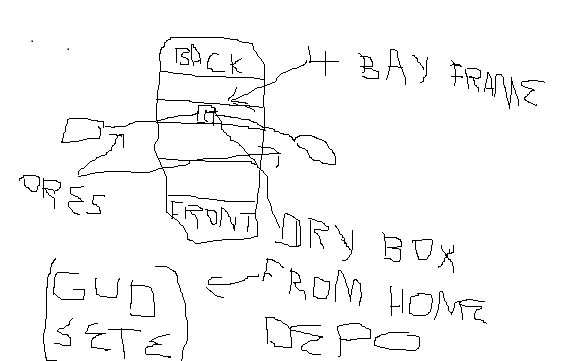

Re: Questions for you raft guys/gals
Post by PBI » Wed Dec 03, 2014 1:03 pm
It's true we finally admitted Paul but only after he agreed to let me weld a Star logo on his Super Puma. At PBI we believe it's beneficial to present a variety of perspectives on rafts and rigging. To that end I've attached another diagram you might find useful. Please don't try to claim it as your own as the copyright process is in motion.
Poverty Boat Diagram.png (10.8 KiB) Viewed 3022 times
Ain't no boat like a poverty boat!
Luke Coop
Chairman and CEO, PBI
Post by Jetlab67 » Wed Dec 03, 2014 1:16 pm
That's a decent sketch POPBI. One more thing to consider: If you wind up using NRS springs and keepers on your oar locks make sure you install the spring PBI-style which is right under the lock and not below the receptacle. Doing it this way acts as sort of a shock absorber especially when using oars made from cannibalized frame tubes and livery paddles.
