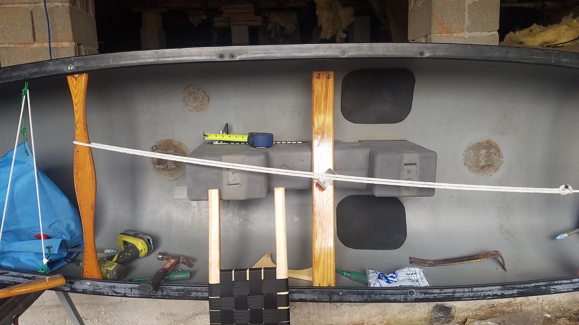

Bought a canoe this January.I could use some guidance on seat placement for my boat. I have a contoured Ed`s Canoe Seat.If my photos attachments loaded with posting,you can see the canoe has the saddle with adjustable foot braces. The last thing my knees need is 7 hours of that. However,i know that there are some moments that it would be great benefit.
Is there anyone that has successfully used a seat and a saddle? I do not want to mount the seat too far back so as to clear the saddle and also think i do not want to trim the back rest of the saddle. As of now it looks like the saddle will be trimmed unless somebody has a wiser option.

Your Sunburst is more a whitewater boat than a flatwater canoe. Not saying that it can be paddled on flatwater. Looks like the Perception saddle with its seat/thighbrace design is what you would want to go with. Came in handy when I used my Whitesell Pyrahana on a western river trip where we had some long pools and no places to stop and stretch.

Once upon a time I bought a Sunburst (not Sunburst II) with no outfitting. I installed knee pads and thigh straps and a web set with the front lower than the back by a few inches. I forget how many but it was enough to make paddling on my knees while leaning against the front of the seat fairly comfortable; same concept as a leaning thwart. My motivation was the same as yours; eliminating the need to be on my knees all day. I ended up spending most of my time kneeling anyway because the boat's design (especially lack of depth) made it pretty awkward to paddle from the seat, and I found that kneeling didn't bother me all that much unless I was paddling a lot of flat water, which the Sunburst wasn't designed for anyway. Your Sunburst II is a little deeper than my Sunburst was, but I still think you'd be disappointed with the results if you added a seat. If you decide you can stand kneeling after all a Perception saddle as Roger suggested would be a good option provided you can find one (I might know a guy). Keep in mind that would add quite a few pounds to your boat.
All that said, you're entitled to an answer to the question you asked, so........if you're determined to proceed with the seat I think your best bet is to remove the saddle altogether and plan for your butt to go right where it would had you left the saddle in. You'll want to install the seat as low as possible but high enough to get your feet out from under when you flip (less foot space will be required than you think).
You never said where you intend to paddle your new boat; hopefully not Greers Ferry since you already have a flat water canoe and WW canoe+flat water+wind= If you haven't already I encourage you to spend a little time in the boat in its intended environment before you commit to a seat. Have fun with the project!
