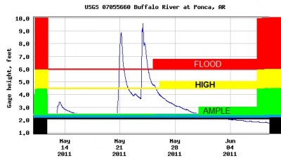

As you can see, it can go from flood to too low within a week.

Short answers:
1) No matter how high the river goes, even record floods, 3 days later if there is no rain it will be below 5 feet.
2) To predict the level after any major "spike" in level, use this chart:
http://arkansascanoeclub.camp7.org/Defa ... eId=490064" onclick="window.open(this.href);return false;
And now, because I can't resist, the detailed answer:
This is so wild, I hardly believe it myself. But you can use the Cossatot River Level prediction chart for the Buffalo River at Ponca too. Normally we have to develop a chart for each river, but just for grins I looked at the last 120 days of data as Owl suggested, and compared it to the prediction of what the river would be using the Cossatot chart.
Here are some conclusions of that study and comparison:
1) Even when the Buffalo spiked to 18 feet on April 23, 3 days later it was down to 4.6 feet (within your specified comfort range).
2) Using the chart, on Day 1 after a rain and associated spike to greater than 7 feet, the Buffalo remained about 0.3 higher than what the chart predicted.
3) Using the chart, on Days 2, 3, 4, and 5 after the rain, the chart correctly predicted the Buffalo River level to within ~0.1 foot for BOTH of the spikes that occurred on 4/27 and 5/2. I picked these spikes because they were the only ones I could find where the water levels were clearly dropping steadily with no more rain. From 5 feet on down, the Buffalo followed the Cossatot predictions almost exactly for both events.
THAT IS AN UNCANNY LEVEL OF ACCURACY; even for the river the chart was developed for you don't normally hit it that close due to many variations in conditions such as spring conditions (saturated ground) vs summer conditions (dry ground, vegetation soaking up as much rain as it can), etc.
But what it tells me is that I'm not going to even bother to study more data to develop a new chart specifically for the Buffalo; I'm just going to use the existing chart for both rivers now.
