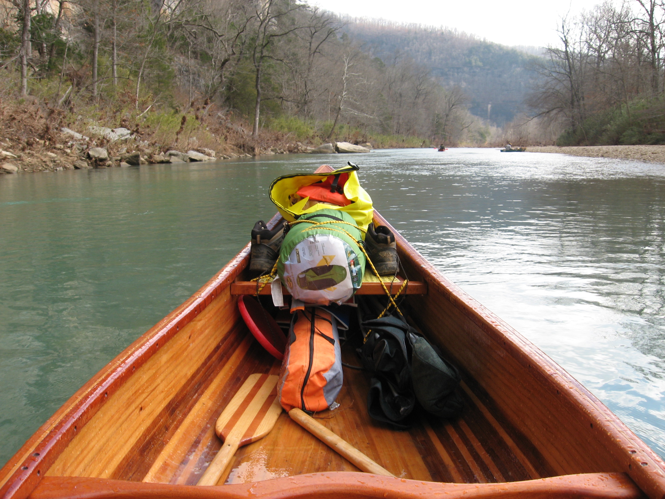

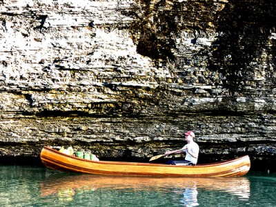

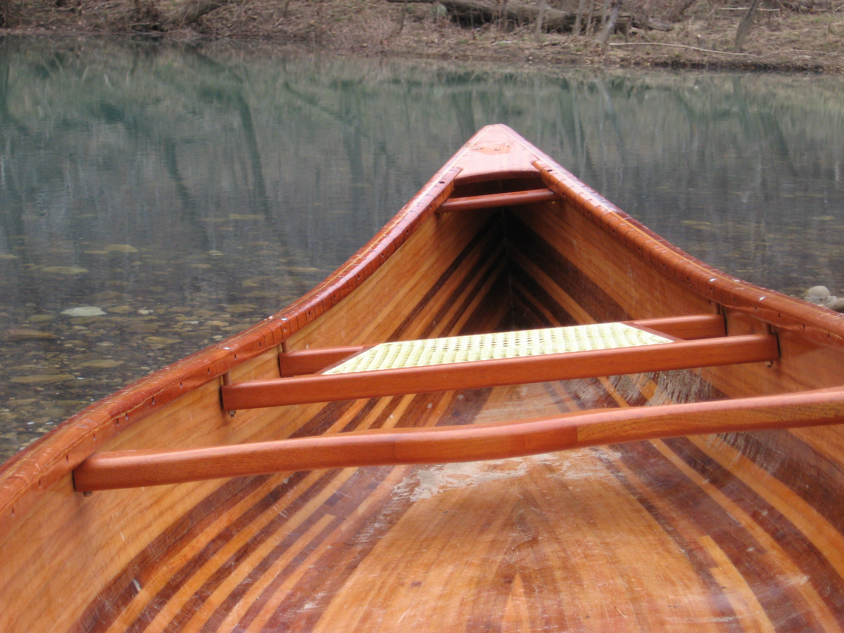

Here are a few pics of my wooden canoe...
My best ones I'll have to upload later...need to find them first.

Re: Wood Canoe
Wow!
That is one beautiful canoe
How much does it weigh?

Thanks guys!
It used to weigh about 90 pounds, but since i've taken it out on the rivers and scratched it up a bit. i've sanded the bottom and reapplied epoxy to it clearing it back out ready for another round, so the additional epoxy i had to put on makes it weigh about 100 pounds.
I put 3 sheets of fiberglass and 6 coats of epoxy just on the outside. 1 1/2 layers of fiberglass on the inside. So I think that was a little overkill. so the next one i make will have 2 sheets of fiberglass on the outside w/ 4 to 5 coats of epoxy, and 1 sheet of fiberglass and 2 to 3 coats epoxy on the inside.
