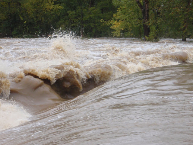

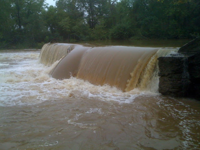

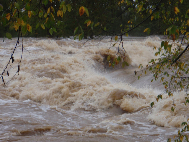

Disclaimer: I know nothing about building a whitewater park
The problem I think people might have with developing out at Pump Station is that it floods often. The water level might be difficult to keep within a specific range for use and to prevent damage to the features.
Low Flood
High Flood
Low Flood
High Flood

Great pics, Regud.
I can't say I've seen it at that "high" flood level. Looks pretty catastrophic to any features. At the level's I've seen it (pretty high) it looked like it would move the stuff under the dam around, but every time that stuff is still there. My original contribution to this thread was to try and get the bed down there cleaned up good and then rearranged so that there would be a close, cheap place to goof off when there was flow. Also it seems like the if the city saw a bunch of paddlers gathering down there every weekday that it rained enough then they would be a lot more inclined to start planning something truly nice. This is to the point where this is definitely over my head. I think we should definitely provide the city with a presentation to keep the idea alive. I am willing to help put that together.
