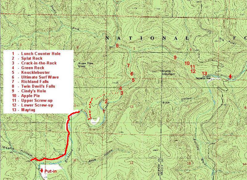

Here is a map I uploaded to the AWA page a while back. I've added the easiest route to hike out of the upper gorge.
The small dotted lines are bushwack areas. For a hiker, start on river left (Crack to Knucklebuster area) and go up the slope to get over the backside of the first big bluff on river left that you encountered on the trip down the creek. IE head Due WEST. You will likely encounter an old road which will take you back South down to the creek noted by the large dotted line. (If you don't notice the old road, then follow the small drainage back down to Richland, it reaches Richland just downstream of the hunter's camp road) Then bushwack upstream along the small bluff to get to the clearings and hunter's camp road noted as a red line. The first clearing will be next to the Big Eddy that Tomcat mentioned. No need to cross Richland Creek.
Note: River right is super steep and is much longer to get out.

Lance, since you posted the map (thanks) I'll direct this question primarily to you, but I'm sure others will feel free to chime in as well. Where's the point of no return if you have a problem on UR and have to walk out? Lance's map suggests you can backtrack to the put in from Knucklebuster, and there's that trail on river right from somewhere around Cindy's Hole/Apple Pie to the campground. What if you have a problem in between? (I guess, Tim Man, if we identify that point we can call it Richland Hiker's Divide).

I'd say if you are at Richland Falls or farther downstream, then work you way toward the takeout along the creek until you find the trail as Cowper suggested.davidbob wrote:... Where's the point of no return if you have a problem on UR and have to walk out? Lance's map suggests you can backtrack to the put in from Knucklebuster, and there's that trail on river right from somewhere around Cindy's Hole/Apple Pie to the campground. What if you have a problem in between? (I guess, Tim Man, if we identify that point we can call it Richland Hiker's Divide)...
Re: Lost Paddler on Richland
Good to know you can skip the part on river right. Even with a boat it is probably 50/50 whether it is easier to drag along the road on the right side. It is in much worse shape than the rest of the road. Pretty soft and sandy with several steep piles of sand washed up that you have to drag your boat over.Lazer wrote:Here is a map I uploaded to the AWA page a while back. I've added the easiest route to hike out of the upper gorge.

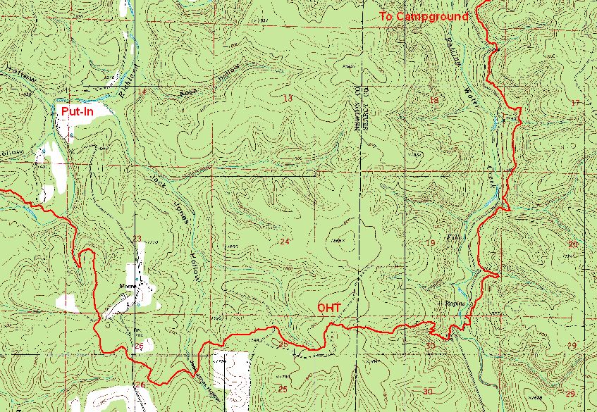

Lots of maps out there (web and paper) for the OHT, which show that it does not follow the Richland Gorge. It crosses Richland upstream of the Moore Bridge and heads South then East to go around the Wilderness Area, then crosses Falling Water at the bridge and then heads North on river and road right to cross Richland again at the Campground.tomcat wrote:the main hiker trail goes from the campground (cross over Falling Water Creek) along Richland on river-right all the way up to the confluence to Twin Devils...and I think that trail keeps going upstream (still on river-right) but I don't know how far up.....maybe this trail is the one that then goes up onto the mountain where this boater had to spend the night. Isn't this trail the Ozark Highland Trail?.....which crosses the put-in road up a mile or so from Dale's cabin?
There is a good trail heading upstream from the campground on river right and a good trail on river left from the trail head in the first road curve that both lose definition a little ways upstream of Cindy's Hole as the walls get steeper and closer to the creek, usually forcing hikers to cross the creek a few times before reaching the Devil's Fork confluence.

So....from what Lazer just posted....that is the OHT that crosses the road into the put-in about a mile above Dale's cabin? But then that trail does not go near Richland until much later at the campground? Then where was this boater/hiker trying to get to on RR as he hiked back toward the put-in? Was he bushwacking or following a trail?
