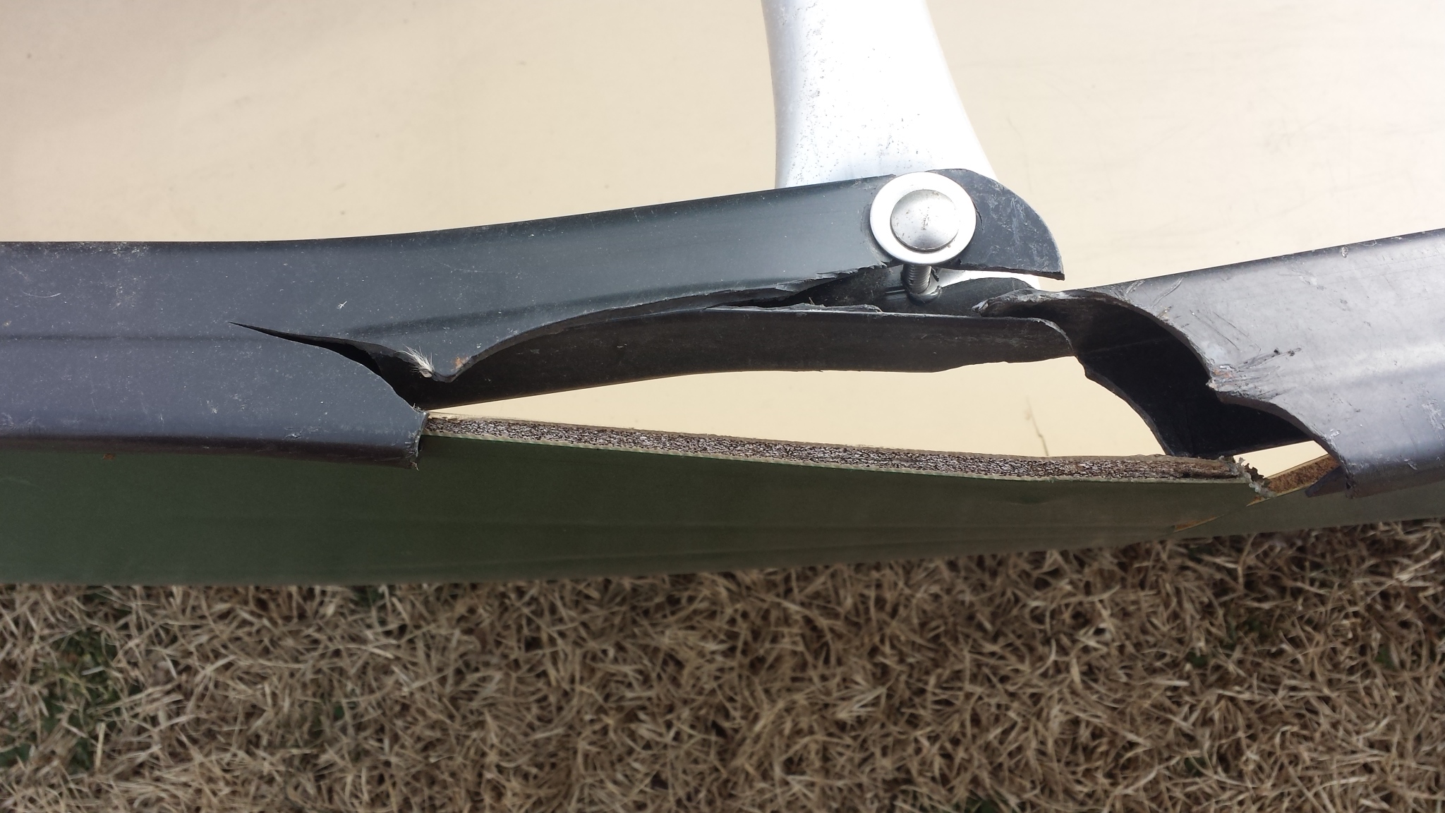

I have a buddy who had a post 2009 Buffalo. He split it almost in 2 halves in Jump Start on the Mulberry, on it's third time in the water. Looking at the cross section of the break, it doesn't look like the old Royalex. Instead of vinyl-ABS-foam-ABS-Vinyl. His boat is thin vinyl - thick foam - thin vinyl. I don't think it's the same stuff. -M-

Third time on the water. He still has it and it's been awhile since I've seen it . So I'm going over there now to get some pix. I'll post them if I can.-M-

Upon much closer inspection, there are 5 distinct layers, though very thin and a thicker layer of foam with visible bubbles in it. It has no Buffalo markings on it. He bought it in Garfield as a "Buffalo Blem". What ever that means. Might not even be a Buffalo, I guess. -M-
Re: Buffalo Canoe - What year was it made?
Post by magicmike » Thu Jan 23, 2014 11:30 am
Pix of the boat in question.
Post by magicmike » Thu Jan 23, 2014 11:32 am
Another angle.
Post by magicmike » Thu Jan 23, 2014 12:46 pm
The older Royalex I've seen, some being my own Probe 14, as well as wrapped and busted boats back in the day. The plastic layers were thicker, and the foam layer thinner and more closed cell. Am I wrong? -M-

magicmike wrote:The older Royalex I've seen, some being my own Probe 14, as well as wrapped and busted boats back in the day. The plastic layers were thicker, and the foam layer thinner and more closed cell. Am I wrong? -M-
That is the case when I compare my Blue Hole Sunburst (circa 1980s) to my Mad River Explorer (circa 2012ish). Can't say whether it's part of the trend overall because I don't have that kind of experience.

Couple of years ago, Kim brought home half of a purple Buffalo that their group salvaged off the Buffalo. I noticed then that the "royalex" being used looked nothing like what I was used to in other boats. Very thin in it's construction with no rigidity to speak of. Not to mention that the gunnels were simply vinyl with no other material to lend strength.

Roger - I forgot to mention the gunnels on this boat. As you said. They're different. Very brittle and hard. The vinyl gunnels on the Probe feel rubbery, and the ones on his boat feel ready to snap.-M-
