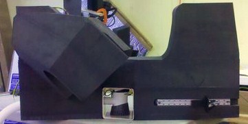

Was wondering if anyone has installed one and if so how well does it work? Just wanna make sure its worth it before I drill a hole in it. Any info would be greatly appreciated. Seen one setup where the pump is under the saddle and battery and wires all contained in an otterbox in the saddle also. Cool setup.

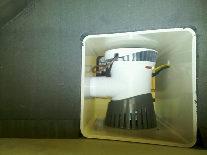

What model boat are you planning on installing a bilge pump system? It is not necessary to drill a hole in the hull to install a bilge pump system. Simply run your exhaust port over the gunwale. As for installing the pump under the seat, Bob Britt taught me an effective method of utilizing a 4”x4” vinyl fence post. This gives support to the saddle while allowing water to flow from each side of the saddle.

They are definitely worth having. I put one in my Taureau, but if you don't buy a saddle with everything ready-to-go, you'll be futzing around with where to put the battery. I am still not satisfied with my installation, but I blame the fact that my boat clam-shell's in the saddle, so I can't pull it out to route cables, tubes, and dig out a battery compartment. If you aren't excited about doing the work yourself there are several people around the state who do great work. I would offer, but I've got too many projects on my own boats to be working on somebody else's... :roll:
