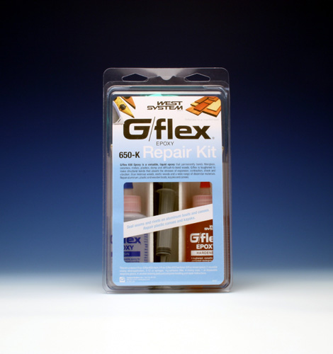

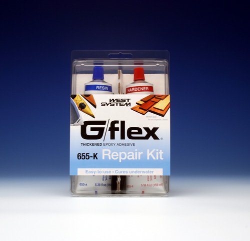

WEST SYSTEMS G-FLEX or just drop it off @ buffalo river canoes , and we'll have it ready in about an hour!

painterbob wrote:WEST SYSTEMS G-FLEX or just drop it off @ buffalo river canoes , and we'll have it ready in about an hour!
I'm with Painter Bob on this one. G-Flex is versatile, flexible, and really tough stuff. However, G-Flex doesn’t reach its initial cure until 7 – 10 hours and it doesn’t reach a full cure until 24 hours. So, having a boat ready to leave the shop in “one hour” might be a little hopeful. Also, there are two types of G-Flex available, 650 and 655 (thickened). Depending on the size of the boat's hull cracks, you might want to go with the 655 (thickened) if they are larger. Here is a link, I'm sure most have seen, to the West Systems G-Flex demo and torture video:
http://www.westsystem.us/ss/g-flex-torture-demo/" onclick="window.open(this.href);return false;
http://www.westsystem.us/ss/g-flex-demo/" onclick="window.open(this.href);return false;
