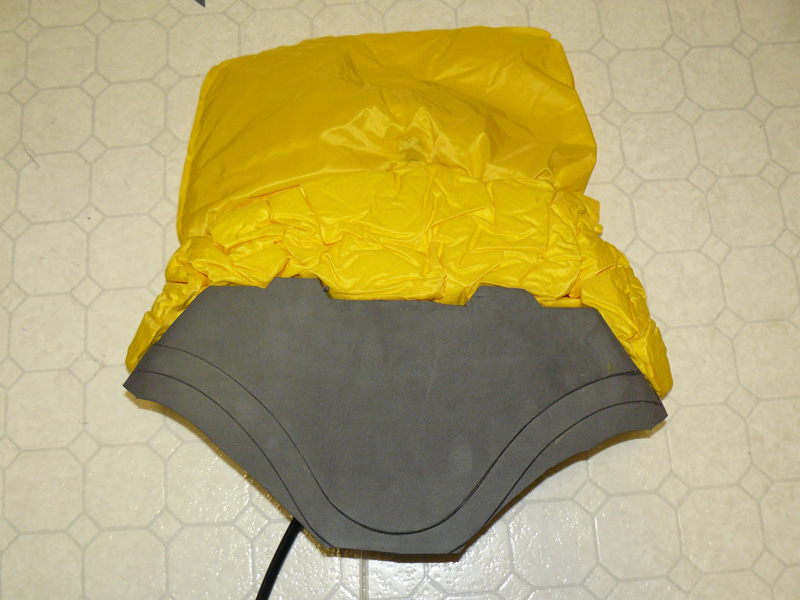

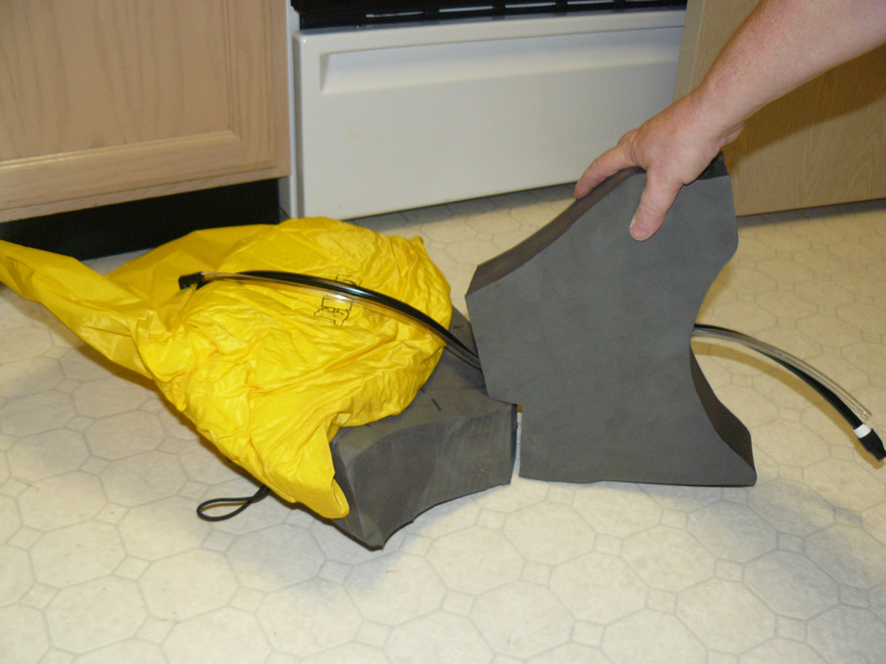

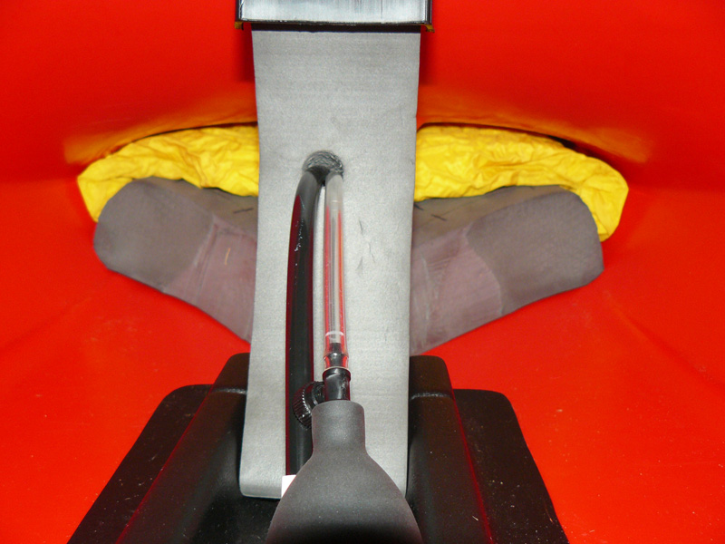

Hey Harlan,
I needed to add a bulkhead to my 4Fun - should be the same basic idea. Here's pics of the general shape I made it. The notch is for where it fits in behind/in front of the pillar. I put mine in and still used the happy feet - basically I used the beads to hold the foam in place, and I can still use the air bladder to make small adjustments in the bulkhead placement - enough to add air for a tighter fit when I'm in shorts, vs. let air out to make more room when I've got more layers on or wearing heavier shoes. I can't remember if I also had to add some foam to the very front of the bow too...I think I did, but can't recall.
You might need something slightly different as I have pretty small feet, but maybe this gives ya some ideas...
See ya,
H
See ya,
H

Here's a bump for any new Jackson owners with short legs. I vaguely remembered this thread, Lupe's contribution in particular, and thought it might be as useful to someone else as it was to me. I paddled Lupe's 4Fun at Canoe School and have had 4Fun lust ever since. I was admiring her adjustable footblock at the time, but my piano legs still wouldn't reach it (Female paddlers, without exception, are all taller and more elegant than me). Anyway, I finally came across one of the 4FUN classic models with linear plastic (lots of linear plastic. The thing is a tank!) and the cheaper outfitting. I love the simplified seat but the footblock was too small to even come close to fitting my 29" inseam. Fortunately, I happened to have some Happy Feet (the largest "150" size) in my Dagger ID. Following Heather's inspiration, I glued the three pieces of the block together (Obviously you could use a fresh block of foam if you had an Elite model with the Happy Feet). I trimmed the curved profile just a bit to make it more compact and cut away quite a bit of material from the front of the block to make room for all the extra beads. I trimmed bit by bit until it would just jamb into the bow with the bag deflated and my knees slightly straightened. I also left some protrusions on the front of the foam block thinking that it would further limit side-to-side motion of the block, which it seems to. The last step was to cut the front pillar to allow enough rearward clearance for the footblock. The setup is rock solid! I get just enough block travel to adjust for different layering and boot sizes and it pumps up super tight!
Nothing new here, but perhaps a very slight refinement of someone else's great idea. Just bringing it back to the front for someone who might not of seen this yet. Thanks, Lupe!
~Dave
~Dave
